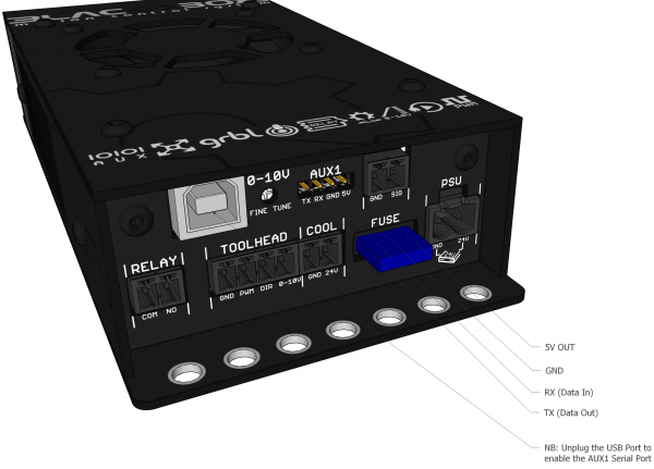

OpenBuilds BlackBox X32 incorporates a circuit that can disconnect the USB-Serial (FTDI) IC from the Microcontroller, and connect the microcontroller to the header pins on the AUX1 header on the USB side of the controller.
  • If the USB cable is connected and delivering 5v to the controller, the AUX1 header is DISABLED
  • If the USB cable is connected and not delivering 5v to the controller, the AUX1 header is ENABLED
  • If the USB cable is NOT connected to the controller, the AUX1 header is ENABLED
  • Whenever the AUX1 header is ENABLED, the USB-Serial connection is DISABLED. The USB endpoint is active, but data will not be sent to/from the Microcontroller on the Brains board.
The port has the following connection parameters:
  • Type: UART TTL Serial
  • Baud Rate: 115200
  • Port voltage: 5v TTL (Use your own level shifting hardware if you intend connecting to 3.3v systems)
  • 5V output is provided for powering microntroller based devices, do not exceed 500mA current draw. Can not power a Single Board Computer from this pin
