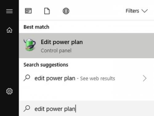

4.2.1. Open "Edit Power Plan"
The quickest way to access this setting is to perform a search in the start menu for “Edit power plan” (no quotes) and selecting the best match.

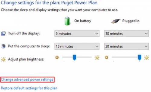

4.2.2. Open "Advanced Power Settings"
In the “Edit Plan Settings” window that opens up, click the “Change advanced power settings” link.

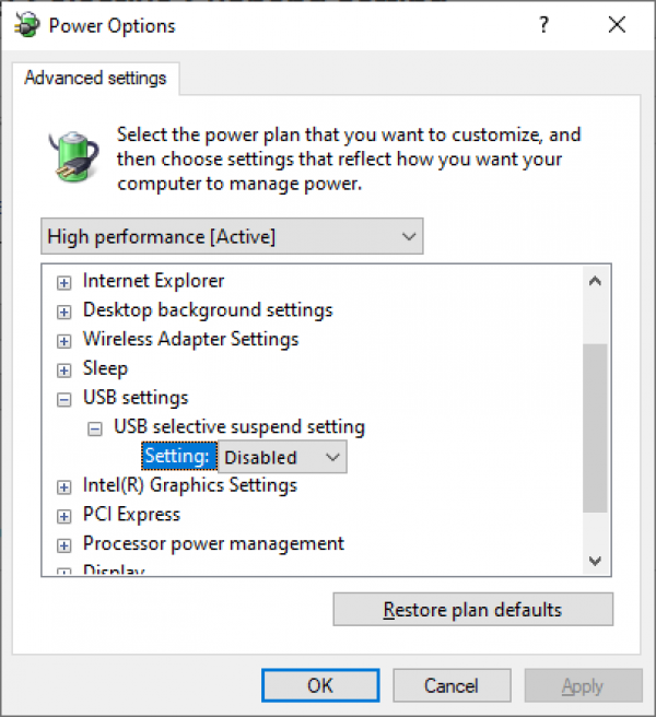

4.2.3. Open "Disable USB Selective Suspend"
In the “Power Options” window that opens, expand “USB settings” and you should see the USB selective suspend setting.
NB: Make sure to set one/both to “DISABLED
