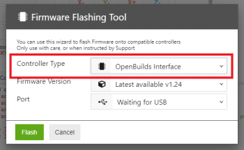

3.3.1.3 Launch the Firmware Update tool
Start OpenBuilds CONTROL and go to Wizards and Tools > Firmware Flashing tool
3.3.1.4 Flash the latest Firmware
  • Under the Controller Type, select OpenBuilds Interface
  • Under Port, select USB Serial port that belongs to the OpenBuilds Interface
  • Click Flash button in the Wizard
  • While its flashing the screen on the Interface will be black
  • The Serial Log in CONTROL will indicate progress
  • Click Reset once the flashing is completed
3.3.1.5 Log
The Serial console log will let you know whether the flashing was successful. Click Reset once the flashing is completed to restart the Interface with the new firmware
