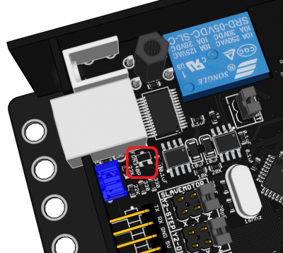

b) Remove Q25 / FDN340P Transistor near USB port
Right next to the USB socket, on the Brains board, is a transistor labelled FDN340P, or Q25, depending on the specific board revision. We will be removing this transistor from the Brains Board.
We have found a very easy, no desoldering required, method of just gently wedging the component off the PCB using a flat tipped screwdriver: (This will not void your warranty, as we approved the procedure)
  • Identify the 3-legged SOT23 transistor: - you will find either FDN340P, or Q25 printed next to it, its right next to the USB port, and behind the 0-10v adjustment potentiometer.
