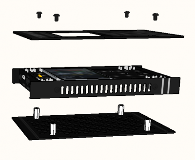

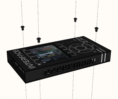

Remove the 4x M3x6mm Hex Screws from the front panel
2. Remove the Back Panel
The front panel screws also hold the back panel on. Once the screws are removed, you should be able to remove the back panel with its spacers still attached. Handle the Interface main body with great care to prevent damage to the LCD - it is only held in place by the front panel.
Turn the Interface around carefully (The jumpers pins we need to access are on the back of the main board) and place it down on the table.

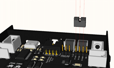

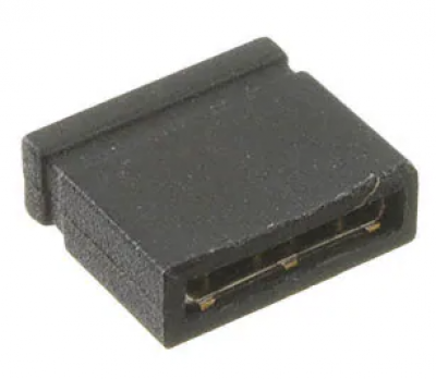

Included with current BlackBox X32s, you will locate a spare 3-Way Jumper in the box.

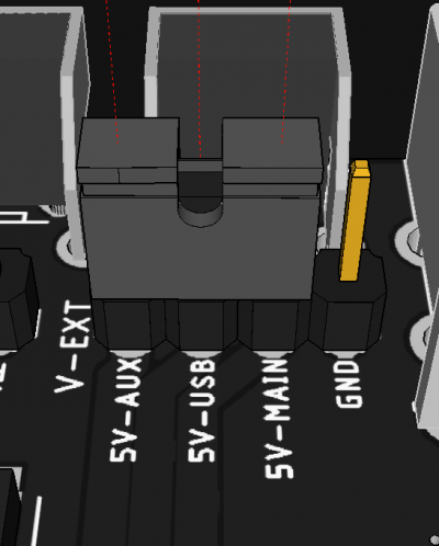

Take the 3-Way Jumper from the BlackBox X32 packaging and install it on the 5V-AUX/5V-USB/5V-MAIN pins of the V-EXT JUMPER.
4. COMPLETE
Make sure the jumper is correctly installed (IMPORTANT: DO NOT LET THE JUMPER CONNECT TO THE GND PIN)
Reassemble the Interface by placing the back panel onto the main body, position the front panel back onto the front, and install the 4x M3x6mm screws (Reverse order from disassembly)
