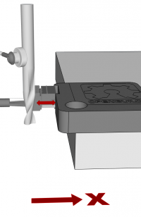

X-Zero Probe
Start with the endmill off to the left of the Touchplate:

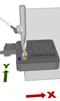

Y-Zero Probe
Start with the endmill off toward the front of the Touchplate:

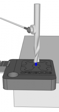

Z-Zero Probe
Start with the endmill slightly above the Touchplate:
