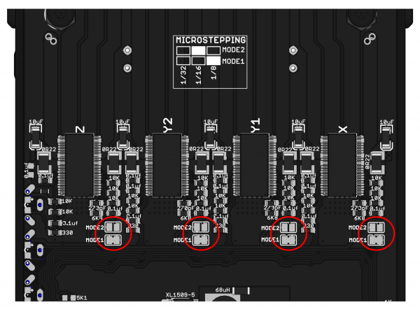

OpenBuilds BlackBox supports different Microstepping values for advanced users.
By default we run at 1/8th Microstepping for better Torque. By keeping the 1/8th Microstep configurations, you will also be able to take advantage of all our predefined Machine profiles.
However, if you are doing a custom build, you can find the Microstepping Solderjumpers on the Bottom of the Muscle Board (Take the BOTTOM Panel off to reach them).
  • To run 1/8th microstepping: Close the MODE1 Jumper, and Open the MODE2 Jumper, for the relevant axes [FACTORY DEFAULT]
  • To run 1/16th microstepping: Open the MODE1 Jumper, and Close the MODE2 Jumper, for the relevant axes
  • To run 1/32nd microstepping: Open the MODE1 Jumper, and Open the MODE2 Jumper, for the relevant axes
See https://learn.sparkfun.com/tutorials/how-to-work-with-jumper-pads-and-pcb-traces/all to learn how to use Solder Jumper Pads
