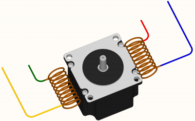

These two coils are wrapped into a complicated stator pattern inside the motor, but electrically, it is just two coils of wire each with a wire on each end of the coil.
Imagine for a moment, that you could see these coils inside the motor: It would looks something like this (simplified) - where there are two coils, each with a wire on each end. This typically gives you 4 wires coming out of the motor.

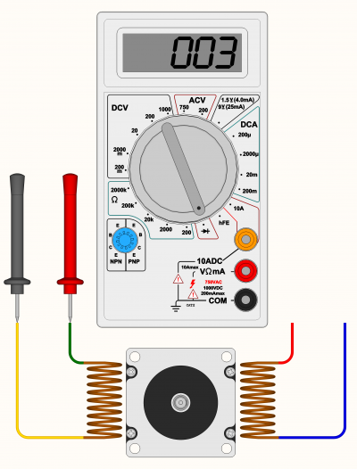

3. Procedure (with a Multimeter)
3.1 Set your Multimeter to Continuity
Set your Multimeter to Continuity / Diode Test mode:
3.2 Connect the Negative probe

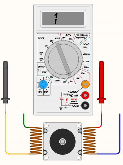

Start with any random wire, and touch that to the Black/negative probe on your multimeter
3.3 Test first wire
Select any remaining wire and touch it with the Red/Positive probe of your multimeter: You have a 33% chance of finding that first wire's companion on the first try, but lets assume you did not. Thanks to our visualisation of the coils, you can see that we hit a wire belonging to the other coil on our first try. So that's not the one we are looking for… If the Multimeter shows [1] it means “no connection” - indicating we did not find a coil between these two wires. Some multimeters also “beep” when it does find a connection, so if there is no beep noise, it also could indicate the coil is not between these two wires

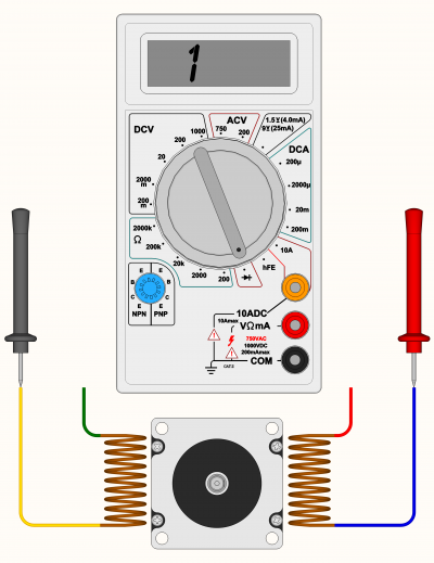

3.4 Test another wire
Let's try another wire, again a 33% chance you are going to find the one we are looking for. Keep the Black/Negative probe on the wire from (2) above. As you can see, multimeter is still showing us [1] (and no 'beep') so we still did not find the wire that pairs up with the wire touching the Black probe…

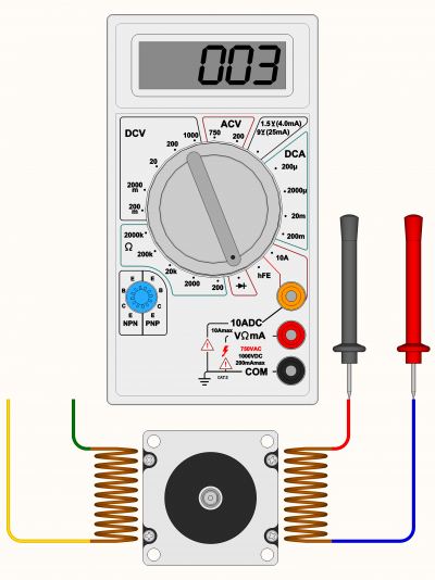

3.5 Test correct wire
Moving to the last remaining wire, we finally see a reading on the multimeter. The actual number does not matter too much, its more important that it has some low value reading, and that the multimeter no longer displays [1] on the display. Some multimeters may “beep” when you have continuity between the wires (circuit completed by the coil in between)
Segment off these two wires and label them as belonging to a coil.
You can wire these two wires, to A+ and A- on your stepper driver
3.6 Confirm remaining wires has a coil
Lets just probe the two remaining wires to make sure there is a coil between them: If there is, as shown below, label these two wires as belonging to a coil. Display should show a reading, and the multimeter may beep
You can wire these two wires, to B+ and B- on your stepper driver

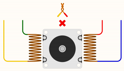

4. Procedure (without a Multimeter)
4.1 Twist together two random wires

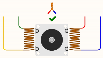

Start by taking any two random motor wires and twisting/touching them together as shown. If the two wires you joined together, belong to one coil, they will self-induce a magnetic field in the motor when you try to turn the shaft by hand. This will be noticable with an increased resistance against turning, and may even feel like you are turning against a clicking feeling. If that shaft still spins easily, you have not identified a coil yet

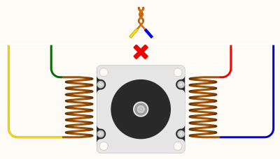

4.2 Try a different combination
If you have not identified a coil yet, disconnect the two wires joined together before, and join a different pair. In the example below, you can see that this wire pair still does not belong to the same coil. If the two wires you joined together, belong to one coil, they will self-induce a magnetic field in the motor when you try to turn the shaft by hand. This will be noticable with an increased resistance against turning, and may even feel like you are turning against a clicking feeling. If that shaft still spins easily, you have not identified a coil yet

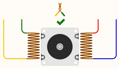

4.3 Find a valid combination
If you join together two wires that do result in the motor presenting resistance against turning, you can label these two wires as belonging to the same coil, and wire them to the A+/A- outputs of your stepper driver
4.4 Confirm the remaining pair also forms a coil
Repeat the test with the remaining two wires, just to confirm that they are also a pair connected to one coil. If it is, you will feel the tell-tale resistance against turning the shaft by hand.
Label this pair as a coil-pair and wire them to B+/B- on your stepper driver.
