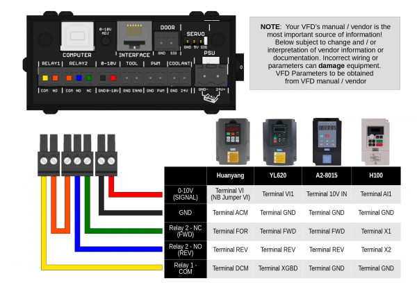

OpenBuilds BlackBox includes a 0-10v Analog Signal Voltage output that can be used to control spindles/other toolheads that need a 0-10v signal to run.
NB Note this is a low level logic Signal voltage, it should not be used to drive anything directly. This signal should be connected to an external drive system, for example a VFD or a DC Spindle Controller. If you need help, head over to our Forums to ask about specific devices and how to connect them
  • To use the signal, connect between the GND and 0-10v pins on the 0-10v plug as shown.
  • To Activate the signal, send an M3 Sxxx where X=0-1000 (1000 = default Grbl configuration, or send S=what you have set for $30 - Max spindle speed, RPM). For example, to have a 10v output send M3 S1000, to have a 5v output send M3 S500, to have a 1v output send M3 S100 etc. (NB scale accordingly if your $30 is not '1000')

Calibrate output voltage
TIP: You may need to fine tune the output to be exactly 10v:
  1. Send an M3 S1000 to the controller (1000 = default Grbl configuration, or send S=what you have set for $30 - Max spindle speed, RPM)
  2. Measure the voltage between GND and the 0-10v Terminal
  3. Use a small flat head screwdriver to adjust the 0-10v Fine Tuning Adjustment until the output is exactly 10.0v
This will ensure that command Spindle RPM is as close to the actual as possible
Generic wiring instructions:
This example uses RELAY1 as the Tool Enable, RELAY2 as FWD/REV and the 0-10V Output as speed CONTROL to control the VFD's activation, direction and speed respectively
