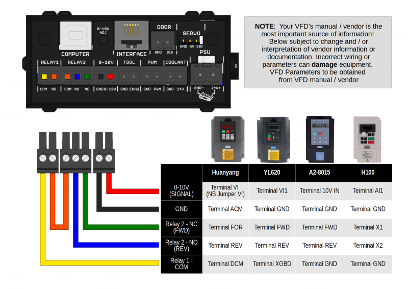

Generic VFD wiring instructions:
This example uses RELAY1 as the Tool Enable, RELAY2 as FWD/REV and the 0-10V Output as speed CONTROL to control the VFD's activation, direction and speed respectively.
Every VFD brand labels their inputs slightly differently, and they all have different parameters to essentially set up the same features, but as can be seen from the diagram above, and cross referencing your VFD manual, you should also be able to adapt to other VFDs as well - almost all VFDs accept a dry contact enable/fwd/rev signal, and analog voltage 0-10v speed signal.

VFDLink
Huanyang VFD https://openbuilds.com/threads/vfd-spindle-control-via-openbuilds-blackbox-controller-and-software.15167/ - NOTE writeup is for the older BlackBox 4X - just adapt to new terminal position on BlackBox X32
YL620-A VFD https://openbuilds.com/threads/yl620-a-vfd-settings.15780/ - NOTE writeup is for the older BlackBox 4X - just adapt to new terminal position on BlackBox X32
A2-8015 VFD https://openbuilds.com/threads/a2-8015-vfd-inverter-with-1-5kw-air-cooled-spindle.19447/ - NOTE writeup is for the older BlackBox 4X - just adapt to new terminal position on BlackBox X32
H100 VFD https://openbuilds.com/threads/h100-vfd-220v-with-1-5kw-spindel-2-poles-air-cooled-with-black-box.19442/ - NOTE writeup is for the older BlackBox 4X - just adapt to new terminal position on BlackBox X32 and wire the Direction terminals via the Relays instead of direct GPIO
