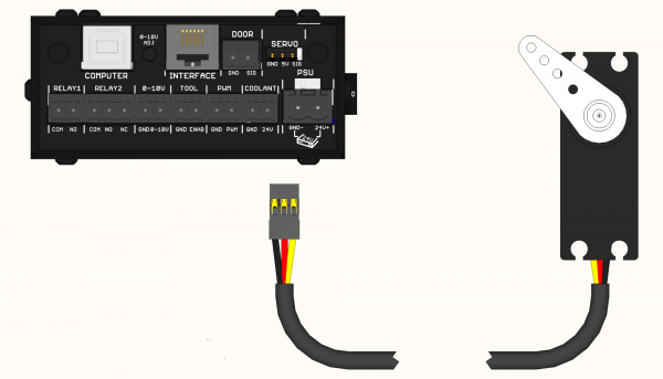

Important note on current (amperage):
Please note the BlackBox can only supply around 250mA for powering micro servos etc.
If you want to use a more heavy duty servo that may pull more than 250mA it would be recommended to use an external power source for the servo, otherwise you might damage the BlackBox
Wiring
OpenBuilds BlackBox provides support for using an RC servo to raise/lower a pen, in Pen Plotter type applications, or other imaginative uses
