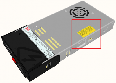

3.1.1 NB: Set the 115/230v Switch
Before connecting your power supply to mains power, it is critical that you check and set the 115v/230v Switch on the right-side of the PSU:
Look out for the bright yellow sticker on the top, to help you locate the switch:

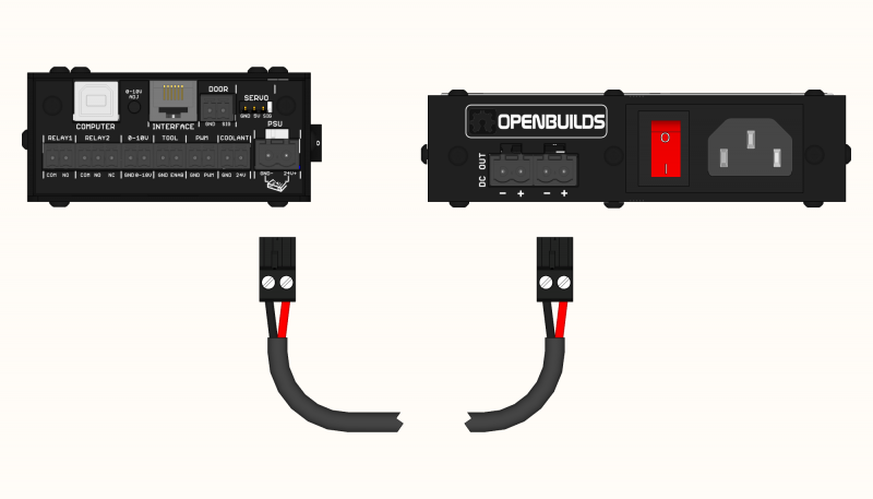

3.1.2 Connecting OpenBuilds PowerCase on a Meanwell LRS350 24v to the BlackBox X32
