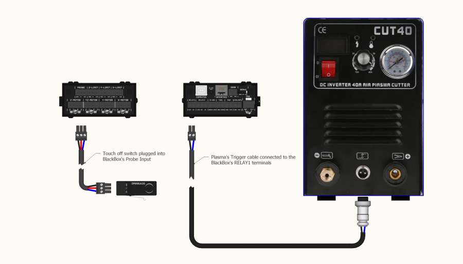

3.3.4 Connecting BlackBox X32 to an Air Plasma Inverter, with Z Touchoff Switch
