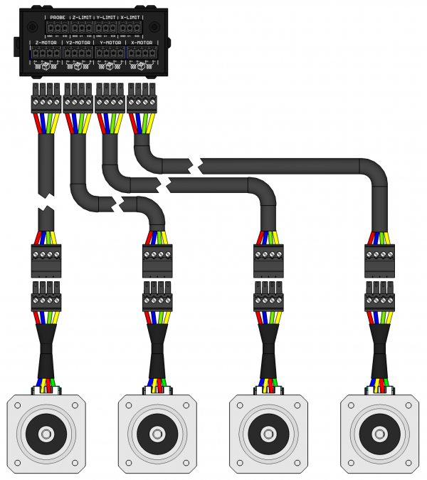

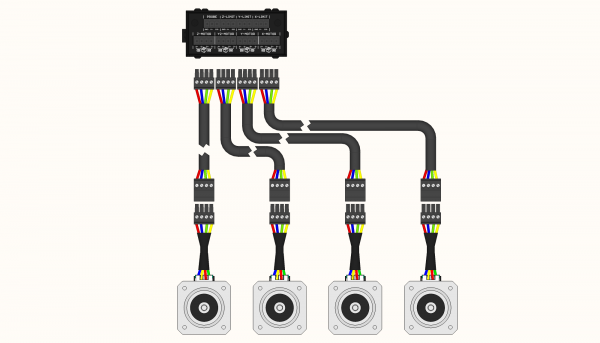

IMPORTANT WARNING: Note: Never connect/disconnect motors to a powered-up controller. Always turn off power before connecting/disconnecting accessories to/from your BlackBox
Note if you are not using OpenBuilds Motors, refer to FAQ: Identify Motor coils to identify the coil pairs. The color codes shown below only apply to OpenBuilds Motors
