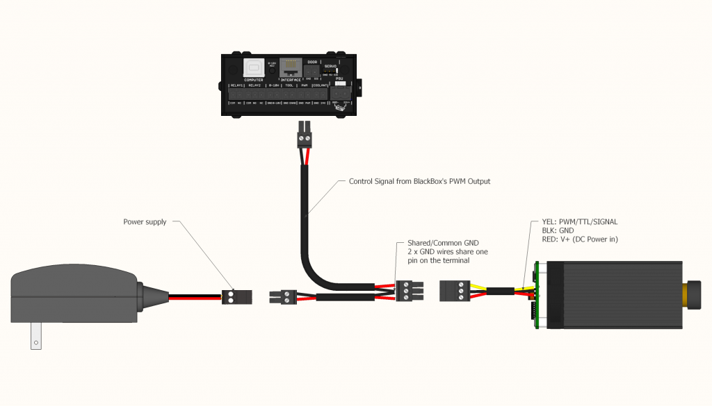

3.3.2 Connecting BlackBox X32 to a 12v Laser Module
