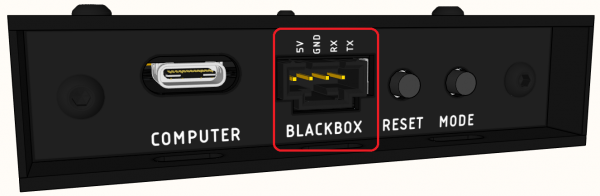

The OpenBuilds Interface can be wired to almost any Grbl 1.1 based CNC controller if it has a UART to connect to.
You will likely need to make up / modify your own cabling, the included cable is designed to be a direct fit for OpenBuilds BlackBox.
Pinout
Pin on Interface's BlackBox connector Pin on your controllerNotes
5V 5V 5V output from your controller, to provide power for the Interface (500mA required)
GND GND Ground connection for serial and power
RX TX Connects to Transmit pin on your controller's Serial port
TX RX Connects to Receive pin on your controller's Serial port
