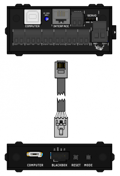

2.1.2 Connecting OpenBuilds Interface to OpenBuilds BlackBox X32
Order your OpenBuilds BlackBox X32 Motion Control System
IMPORTANT NOTE No 1: Make sure to disconnect the USB cable from the BlackBox: See BlackBox Documentation: Section 5.1 Connecting BlackBox X32 to external Serial devices - this forces BlackBox to switch to the AUX port. When the USB cable is connected to the BlackBox, it forces BlackBox into USB mode (I.e. no communications with the AUX port, and thus no communications with Interface)
BlackBox X32 to Interface V1.3/V1.5/V1.6
IMPORTANT NOTE No 3: See Retrofit older Interfaces for X32 if your have an Interface V1.4, V1.5 or V1.6
