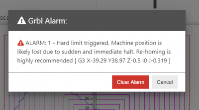

1.3 False Hard-limit alarms
EMI can cause Grbl to falsely think that the Hard limit switches has been hit (when you are sure the carriages did not touch any of the limit switches at the time of the Alarm) . This can largely be avoided by using Xtension Limit Switches with onboard RC filters
