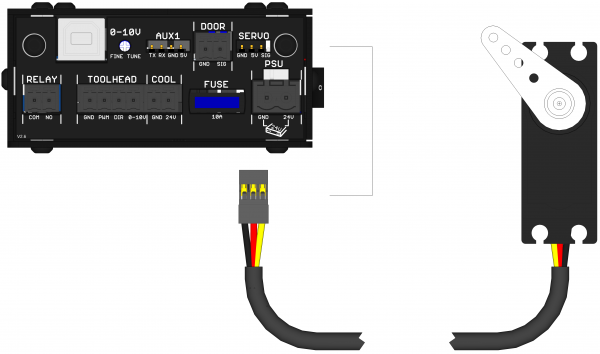

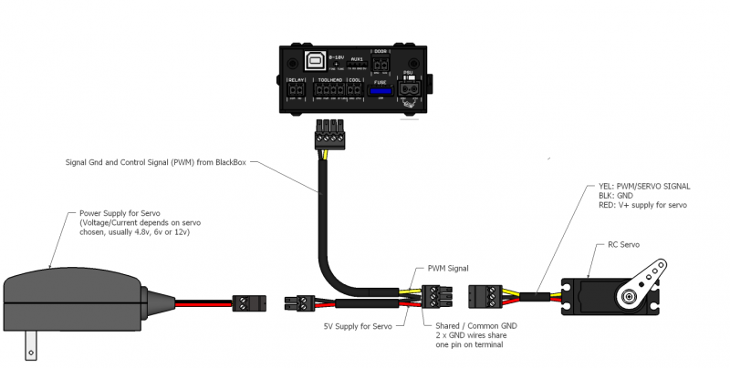

Wiring
TIP: Remove the Relay Mode jumper to prevent the relay from clicking on/off rapidly during servo PWM operations
BlackBox version 2.6 and newer
BlackBox version 2.4 and 2.5 Only
