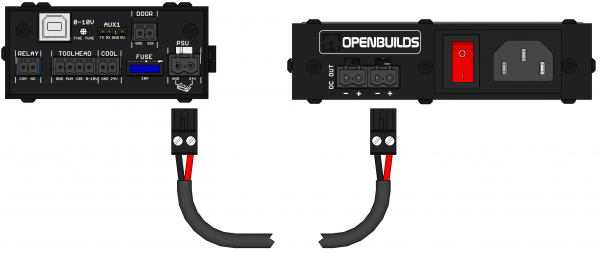

3.1.2 Connecting OpenBuilds PowerCase on a Meanwell LRS350 24v to the BlackBox 4X
