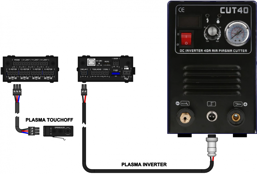

3.3.4 Connecting BlackBox 4X to an Air Plasma Inverter, with Z Touchoff Switch
TIP: Set the Relay Function Jumper to M3/M5 mode to use the relay as a plasma trigger switch
