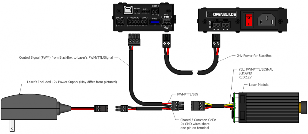

3.3.2 Connecting BlackBox 4X to a 12v Laser Module
TIP: Remove the Relay Mode jumper to prevent the relay from clicking on/off rapidly during laser operations
If you would like to use both a Laser, and the IoT relay, See: Connecting both an IOT Switching Relay for a Router, and a Laser, to the BlackBox
