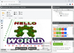

1. Go to OpenBuilds CAM at https://cam.openbuilds.com
2. Click the Settings Button on the Settings Tab
3. Select the controller
Select the relevant CNC controller, Machine and Tools from the Dropdown lists (or scroll down and customise the settings yourself)
