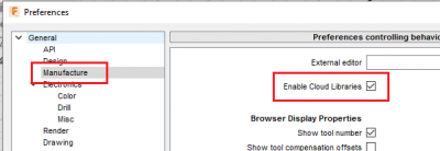

Click on your Name in the top-right corner, and then on Preferences:
Click on Manufacturing on the left, and then make sure the checkmark is set next to Enable Cloud Libraries

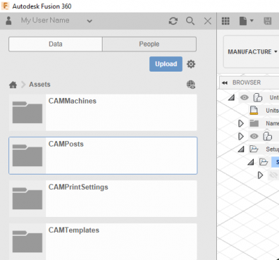

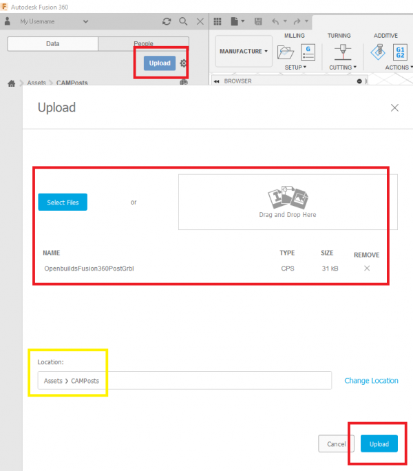

2.2 Upload the downloaded OpenbuildsFusion360PostGrbl.cps file to Assets > CAMPosts

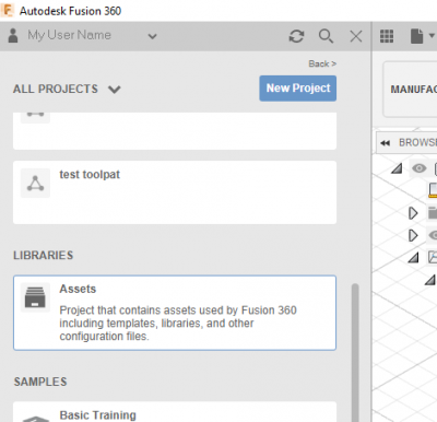

Open your Assets library
Go into the CAMPosts folder
Click Upload, select the downloaded OpenbuildsFusion360PostGrbl.cps file and Upload it

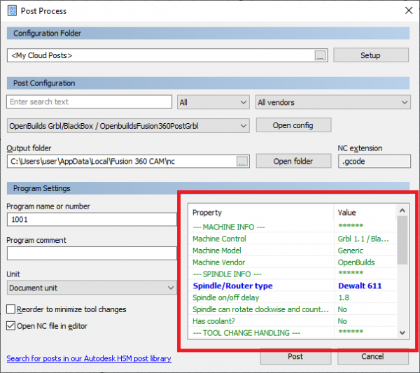

=== 3.1 Post: Use Cloud Posts
Click Setup > Use Cloud Posts
3.2 Select the Post Processor
Select the Post Processor from the dropdown menu:
3.3 Customise Post Parameters (optional)
There are several parameters you can adjust to your choosing to tweak the behaviour and features of the Post
For example, setting the Router type - will include the recommended Speed Dial value in the G-code comments
