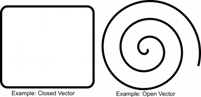

Closed Geometry Vectors
CAM software needs to calculate offsets to do contour cuts and pockets - and most of the mathematics require the vectors you want to use to be “closed vectors”
Closed vectors are shapes where the start-and-end points are the same. An open vector is a line/polyline that ends somewhere other than where it started.
Depending on the drawing and its purpose you can
  • Use it only as an Engraving line (limiting the allowed operations to tools/toolpaths that follow the line)
  • Manually edit and close the line (the example above is not suited to this, but sometimes you do have a shape meant to be closed but due to a drawing error, or file error, rounding mistake, etc the ends are just not closed when they should be)
  • The file may not have been designed for CNC use, either redraw or use a different drawing.
