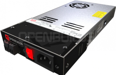

OpenBuilds® PowerCase V1.7 - V1.8

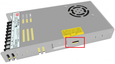

1. NB: Set the 115/230v Switch
Before connecting your power supply to mains power, it is critical that you check and set the 115v/230v Switch on the right-side of the PSU:
Look out for the bright yellow sticker on the top, to help you locate the switch:
2. OpenBuilds® PowerCase Assembly Video
The following video demonstrates the assembly of an OpenBuilds PowerCase
