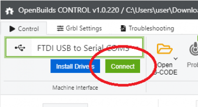

2. Connect to your controller
Use OpenBuildsCONTROL to connect to your controller

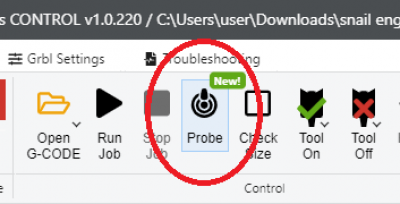

3. Run the Probe Wizard
Run the Probe wizard from the Probe button on the main toolbar

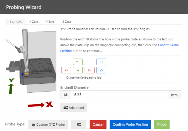

4. Execute a probing operation
Each operation type described how it works, where to position the probe, and any extra parameters directly onscreen on the Probe Wizard window
  • Clip the magnetic probe to the endmill
  • Place the Probe Plate on the front-left corner of the stock
  • Use the buttons onscreen, or your keyboard, to jog the endmill to the position instructed by the wizard
  • Click [Confirm Probe Position] to confirm the probe hardware is ready. This is a safety step to prevent executing the probing operation without the hardware being ready
  • Click [Probe] to start the probing operation
