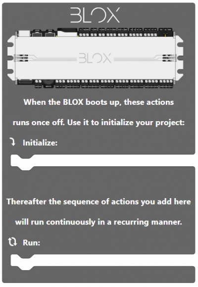

5.1.4 BLOX Block
The BLOX Block is the most important block in your workspace. This block is the container into which all your other development is contained. Only blocks plugged into the BLOX will be included in your firmware
The most important concept is the Initialize vs Run inputs.
Initialization Blocks
This is used to initialize settings and configurations that need to be set up once when the BLOX starts running.
It runs once at the beginning of the program, right after the BLOX is powered on or reset.
Typically used for
  • Connecting to a Wifi Network
  • Setting up Timesync
  • Configuring Stepper Motor's Axis type, Calibration, Current Setting, etc
  • Configure initialization and pin assignments for displays/sensors/modules
Run Blocks
This section contains the blocks that will run repeatedly, allowing your program to perform tasks or respond to inputs continuously.
It runs in a loop after Initialization completes, and it will keep running over and over until the BLOX is powered off or reset.
Typically used for
  • Reading Sensors, Buttons and Switches
  • Manipulating data
  • Sending/Receiving messages
  • Logging
  • Control the flow of the Program with Logic blocks
  • Move Motors or Servo
  • Turn devices on/off
  • Change LED colors
  • Play audio
