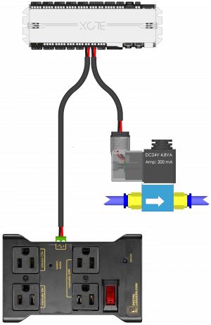

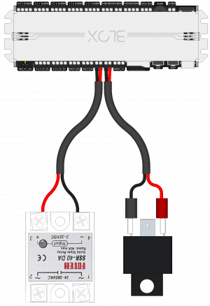

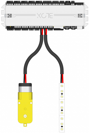

2.7.1 Wiring
BLOX Terminal Device
GND Low side Switched leg
V+ 12-30V (Connected to input power supply positive)
Switched Output Example: Motors / LEDs Switched Output Example: Relays Switched Output Example: IoT Relay / Solenoid

2.7.2.2 LogiBLOX
Use for ON/OFF control of devices attached to the Switched Outputs
Set a PWM (Pulse Width Modulation) value (Useful for dimming LED strips, or controlling the speed of a motor attached to the Switched Outputs)
