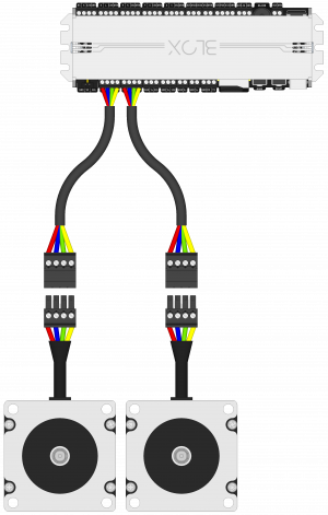

2.5.1 Wiring
Note: The color codes shown below only apply to OpenBuilds Motors. Refer to FAQ: Identify Motor coils to identify the coil pairs or if you have issues with motors not working correctly.
BLOX Terminal Device
A+ Coil 1 (Red)
A- Coil 1 (Blue)
B- Coil 2 (Green)
B+ Coil 2 (Yellow)
IMPORTANT WARNING: Note: Never connect/disconnect motors to a powered-up controller. Always turn off power before connecting/disconnecting accessories to/from your BLOX
Wiring NEMA 17 Motors Wiring NEMA 23 Motors
