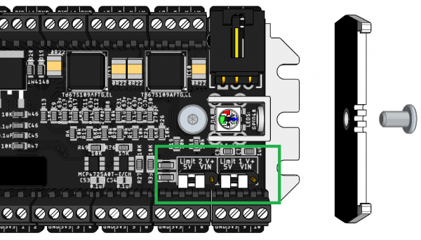

OpenBuilds BLOX can provide power to your limit switches / panel switches / sensors / etc : Please use the jumpers to configure the voltage your endstops need: 5v (the default) would be suitable for most mechanical and optical switches. 24v would be great for inductive sensors. Check your endstops' datasheets to determine which voltage would suit them better.
These jumpers are located underneath the top cover of the BLOX, remove a screw on one of the sides to remove the top cover
Limit 1's and Limit 2's voltages can each be set to individually as needed:
Set the jumper according to the required voltage for the sensor / limit switches attached:
5V Endstops (Default)
12-30V Endstops (Same as input supply voltage)
