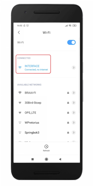

2. Connect to the OpenBuilds Interface's "INTERFACE" access point using your phone
Using your mobile phone is the easiest method of getting the Interface connected to your Wifi Network:

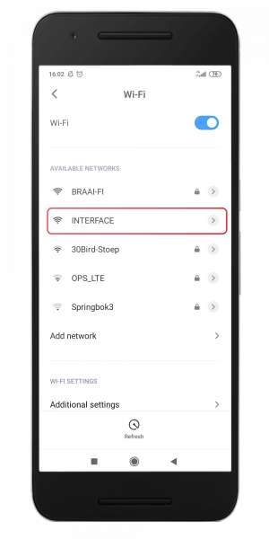

2.1 Scan for the INTERFACE access point
Go to Settings, Wifi and refresh the available wireless networks.
2.2 Connect to the INTERFACE access point
Tap the INTERFACE access point, and wait for it to connect

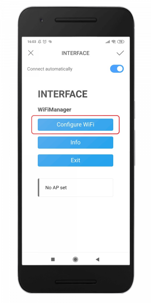

2.3 Configure Wifi using the web interface
After a few seconds, your phone should pop-up the captive portal page
If it does not pop-up automatically, you can open a browser on the phone, and go to http://192.168.4.1 as well
On the resultant web interface, tap on “Configure Wifi”

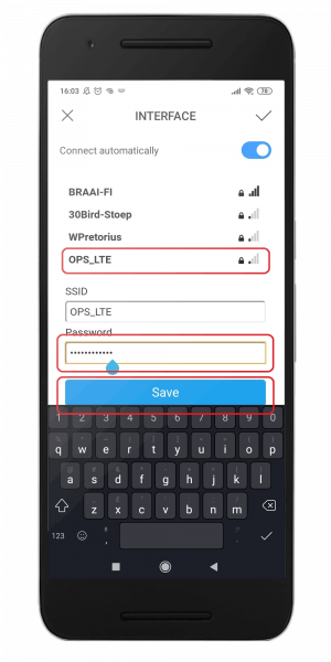

2.4 Connect to your own Wifi Network
Tap on the Wifi network you want to be connected to: Replace OPS_LTE in the example below with your own Wifi SSID Enter the Passphrase, and click “Save”

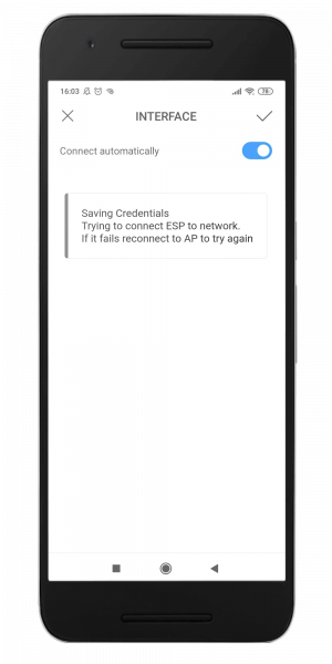

2.5 Complete
The Interface will now try connecting to your Network
3 Reboot to take effect
Once the Interface has connected to your network, it will display your network details, with a green Wifi icon, on the LCD display.
