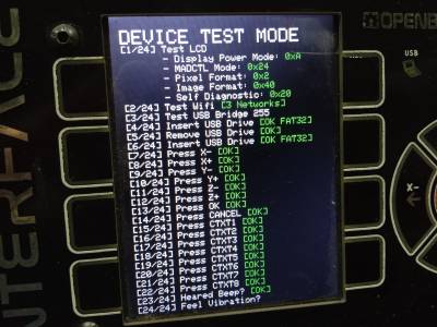

OpenBuilds Interface Firmware V1.51 and newer includes a “Device Test Mode” - used by the factory, but can also be run by End Users - to test the Hardware inside.
Updating from v1.24 - v1.46 and flashing to v1.51 or newer will run the Device Test mode the first time the device boots. This will only happen once, and this step will allow you to do a self-test on your hardware to ensure its all working perfectly
If your Interface shipped out with Firmware v1.51 or newer - it will boot straight into the normal firmware. You won't be required to perform the test as the OpenBuilds QA Team has already performed it for you.
If requested by our Support Team, or for use in your own Troubleshooting, you can launch the Device Test Mode manually. Instructions Below
