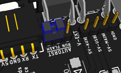

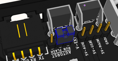

In some circumstances, such as during firmware debugging/development, or if you are unable to use the buttons to set the mode, you can move the AUTORST Jumper to the FLASH position, to enable automatic flashing without needing to press the buttons.
The AUTORST Jumper is inside the Interface, on the back, near the buttons. You do need to take your Interface apart (carefully) to change the jumper.
Remember to move it back to RUN mode once you are done.
RUN Mode
FLASH Mode
